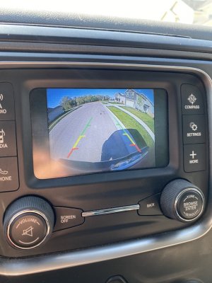

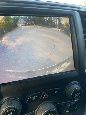

I have mine installed this weekend thanks to mpgrimm2 everything as if it were from the factory the only thing I could not activate were dynamic gridlines a message comes out that shows that my vehicle does not support that option I will contact the alpha developer to see if the can help me even if it still works

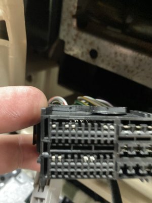

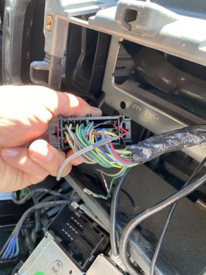

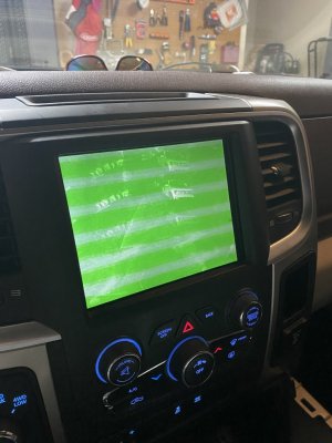

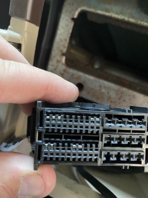

sambrian2007
Jun 4, 2013
10

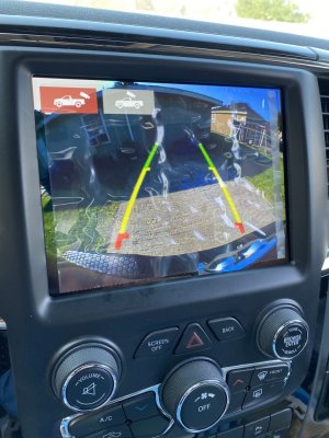

Just wanted to drop a line and say thanks to the people that built this thread and everyone that has shared their expertise. I haven't been on here in awhile (haven't been modding) but when I was having trouble with this install, I knew this was the place to come.
I finished this project up late last week. I "blew it" on the last step plugging into the radio harness. I skipped/missed the pin hole so I was in the harness 30,32,33 instead of 30,31,32. I was able to step back thru the connectors and verify using pics from here. Extremely thankful I didn't tear something up by missing the pin.
I'm attaching files of what it looks like (at least in my case) when you screw up. I've still got the gridlines connection to make but that is for tomorrow night.
Thanks again to the forum.

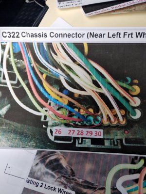

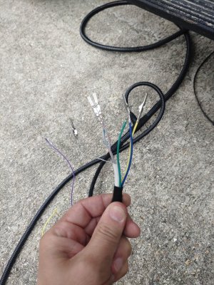

So im looking at the instructions and the wire colors dont match whats on the harness. Please help if youve encountered this problem. Starting to think i got the wrong kit.15890426105792178464849914832703.jpg 15890426635823669187917580473774.jpg
Mpgrimm2
Supporting Vendor Navy Badge
Mar 30, 2014
6,606
5,239
SC
2022 Ram 1500 (5th Gen)
5.7L
That kit bypasses the c322 connector completely, goes to the PDC and splits off/goes though the firewall v where 3-5 of the loose wires get installed into a loose connector assy that comes with the kit.
Free wire splices into the BCM at C5/e -45 I believe. 2nd harness with 3 wires and matching connector goes to the radio.
Go back and look at the links in Post 10 for the schematic and the Mopar kit directions for display in the radio.
