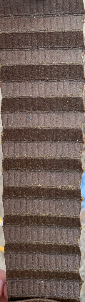

I’m like 5 months and 2700 miles too late from when this filter was removed from the truck and me just now breaking it open (thanks to you), but here’s what I found after finally breaking open my first oil change filter. Looks great to me. Curious to see how the next one looks in April.

Filter looks good! No shiny bits so that's a bonus.
Using premium should reduce your possibility of knock/tick as it's not detonating earlier like cheaper fuels do. You gained that much mileage though?!? Lucky bugger! Lol but honestly seeing your filter I would keep the thought in the back of my head but I wouldn't be overly concerned at this point.
