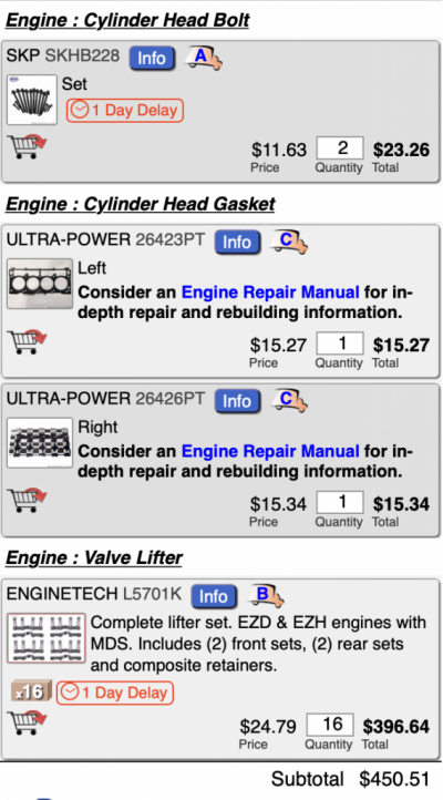

I am looking at these from rock auto.. looks like a good price and I know RockAuto has a good reputation.
Jan 17, 2016
23,714
54,457
14 Sport
Do not buy Engine Tech lifters,they have one of the worst reps of all the cheap lifters. I don't see any posts from you down in Benny's section,so i'm guessing you haven't talked to him and seen what kind of price he has on OEM lifters.At least contact him and go from there.Remember the old saying,you get what you pay for,cheap and good usually don't go hand in hand.
Here's the link to his section,try him first,put a post up looking for OEM lifters,he'll answer you fairly quickly

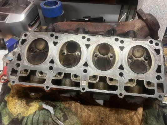

Update on the tear down.
Heads are out, and you can bet.. one of the #3 lifter rollers is flatter than a pancake..
I also got a quote from Benny for $800 for lifters. Yes.. I am going to cheap out again and say that is more than I am going to spend. I found some from MMX for a little cheaper which I will probably be ordering later in the day.
2. I got some dirt in the cylinder holes when taking the heads off. What would be the best practice for getting everything out the best I can.
Also having lots of difficultly taking the valve springs off. I have the common spring compressor, but the sleeves around the spring make it almost impossible to get a grip. I know there is a specific one for the hemi.. but $150 to use a tool once..
Going to take the cam off this afternoon and pray for no damage.
Thanks everyone for your help.
Shop vacuum or even a normal household vacuum for sucking most of the dirt out of the cylinders
