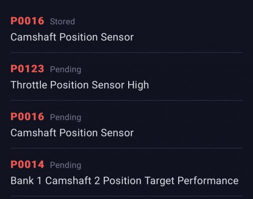

Morning all,
Taking to this group for some help on my cam swap I did on my 09 HEMI. Just got done replacing JUST the cam (no lifters). Re timed it by lining up the marks on the chain with the phaser at 12 o clock and pointing the keyway of the crank at 3 o clock (or towards the 5.7 mark on the oil pump). After starting the truck runs extremely rough and idles high (1.2). Trying to rev it up and it doesn’t go past 2k rpm. Attached are the codes that it is throwing.
So my next question is where do I start. Take the valve covers off and see if the rockers are going down like they should? I’m really hoping it’s not the timing so I don’t have to tear everything apart again.
ANY help would be appreciated.

No I didn’t. But now I see I should have.
And out of laziness I just want to make 100% sure that’s what it is before I go taking everything apart… again.

You should have replaced the lifters. If the old cam was the cause of the misfire then it had a wiped lobe. The lifter on that lobe is probably damaged. Did you inspect the rollers on the lifters?
You are right, one of the cam lobes was eaten up pretty good. No I didn’t inspect the rollers. This is my first time getting really internal in an engine but I have a bit of experience in other realms.

Pull it apart and at the very least replace the lifter that was on the chewed up lobe.The only way a cam lobe goes south,is if the lifter has issues. That applies to even a flat tappet cam

Do not run the truck you will destroy the camshaft very fast if you dont replace the lifter on the cylinder that the lobe was eaten up. I understand time and budget but if your not going to do it right in the long run it will cost you more time and money then doing it the right way in the first place.

If your Valves didn't kiss the pistons take those heads off and do Your lifters. New head bolts too, they're torque to yeild and not reusable.
I did a cam on my truck, replaced everything went through it with a fine tooth comb including break in procedure I installed the non MDS injectors and my cam went again 20k later. Ended up biting the bullet and doing an engine.

Is there any way that I can diagnose the timing and make sure it’s not anything else?

I'm gonna go out on a limb here,but i'm guessing the reason the lifters didn't get checked is you never pulled the heads,you just rotated the cam a couple turns to push the lifters up in the bore,then swapped the cam.You're going to be your own worst enemy for nickle and diming the job and being lazy.The codes won't matter,as you'll probably only get another couple hundred miles out of it,before you're doing the cam again. Pull it apart and do it right or you'll be changing the cam every couple hundred miles.The lifters are what's eating the cam lobe,plain and simple.At the very least you need to replace the lifter that was on the chewed up lobe.Hopefully you haven't already messed up the new cam,but if you keep trying to get it to run,it won't be long before your new cam is also ruined

You are 100% correct ..
I am basing my knowledge off of what I see online. I see many guys say that have been fine just replacing the cam on high mileage trucks. But now I’m obviously hearing different. Was just hoping to now get into the nightmare that comes with taking off the heads/doing lifters.
But I’m still worried about it not running right with the new cam. I guess if I have to take everything apart again I might as well do them while I’m in.. again I was just hoping to not have another 2 week project ..
My next question.. can I leave the cam in now when doing lifters/pushrods/rockers?
