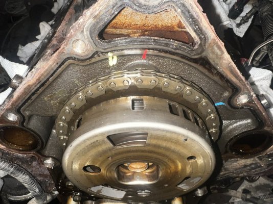

Morning all,
Taking to this group for some help on my cam swap I did on my 09 HEMI. Just got done replacing JUST the cam (no lifters). Re timed it by lining up the marks on the chain with the phaser at 12 o clock and pointing the keyway of the crank at 3 o clock (or towards the 5.7 mark on the oil pump). After starting the truck runs extremely rough and idles high (1.2). Trying to rev it up and it doesn’t go past 2k rpm. Attached are the codes that it is throwing.
So my next question is where do I start. Take the valve covers off and see if the rockers are going down like they should? I’m really hoping it’s not the timing so I don’t have to tear everything apart again.
ANY help would be appreciated.

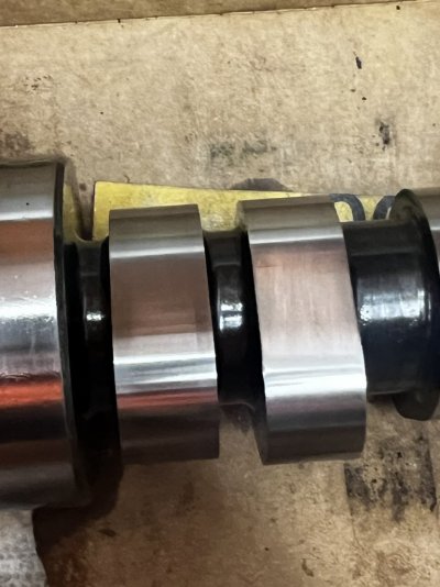

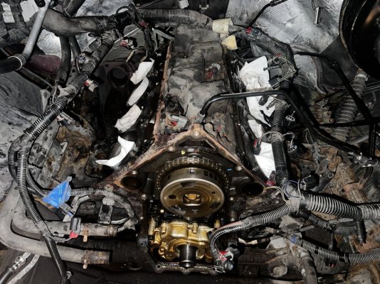

Morning gentlemen..
A little update on the ram.
I took out the cam to find some slight damage to.. you guessed it.. the lobe with the damaged lifter. Speaking of damaged lifter! The failed lifter had a complete flat spot in it. I took the cam to a local machine show where he put it on his cam polisher and sent me home with some 800 grit.. and I installed it after using his advice and doing a little polishing. New lifters were installed, and I just re timed (properly and spun the engine to make sure) yesterday. New head gaskets.. studs.. etc.
PRAYING that this thing runs. My only concern throughout the process is that quite a bit of dirt fell into the internals throughout the process. I did the best job I could cleaning it up, but still.
My next question.. I put the rocker arms on and looking into the intake valves, three of them on the right (looking into the engine) are partly open. Is this right? Or am I doing something wrong...

About the intake valves turn the engine by hand each of them should 100% close at some point if not the push rods are not seated or the valves are bent.
