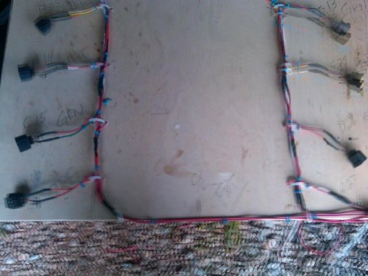

A couple years ago I installed the AutoMeter 9117 and rewired the coil side on the passenger side. I think you will find the 4.7 and 5.7 basically same with how the coil/ injectors are wired. There is a common 12vdc source from the ASD relay. They separate into injectors and coils at the front of the engine and then separate again for the passenger and driver side as separate harnesses. The coil connector as well as the injectors have only two wires. One is the 12vdc source that is constant voltage and the other is the control (driver) wire from the PCM. The power can be supplied any way you like as long as the drivers are going to the correct cylinder. The coils can draw close tor 20amps at WOT, so appropriate wire size needs to be used. Before doing all the wiring I would try tapping one coil and see if that doesn't give you the signal that will work. My bet is it will. Now the down side. When using a signal initiated from the coils or injectors the stock PCM will cut these signals under certain conditions such as RPM limit or hard deceleration. So everything works fine until you hit the rev limiter. I have my wiring considerably modified from doing different installs and now have the injectors and coils on completely different fused circuits. Doesn't make anything better but easier to trouble shoot and do future electrical mods if I choose. Good luck..

Was it a PITA rewiring the coils and injectors? What are you using a tach adapter for? I wonder if mine is any different since I don't have an ASD relay?
I'm pretty sure you do have a ASD relay, both JTEC or NGC uses one to control source voltage for coil, injector and fuel pump. As for rewiring the harness, I don't think it is that difficult. Just need to be a little organized. I have a 1/4 plywood panel with that is the layout of the harness. I use nylon wire tie loops on it to keep the wire neatly bundled. Then run the wires and solder all the plugs onto the new harness. On my 03, all the drivers wire use a plug at the rear of the engine on the driverside. Then the power wires all go forward toward the IPM and I used generic plugs to connect them to the power source. I can unplug the entire harness and lay it on a table. This is when I was putting it together.
Still under construction and is the power source for the fuel and coils.

Nice. I may have some more questions later. I have a spare engine harness that I can use if it works. As for the ASD in 06 they replaced the FCM and ASD relay with the TIPM and the ASD is incorporated into the TIPM.
