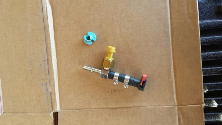

Not being able to pull the relay for the fuel pump to release the pressure to remove the shrader valve on the fuel rail test port sucks. That's where I have to tap into for fuel for the nitrous solenoids.

This is for a fuel pressure sensor but you could also use it for a fuel source.
I installed an external fuel regulator and plumbed a AN connection for a fuel source on the passenger side.

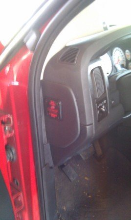

If anyone else has successfully installed a window switch for an aftermarket tach, nitrous, or anything that needs a good clean rpm signal please feel free to chime in.

I currently trigger my shiftlite and window switch off of a coil. I choose to mount the window switch where I could see the gauges while adjusting it. I just pop the cover loose and hold it in my hand to make adjustments.

When you first hooked it up did you already have your coil harness modified? Or was that why you did this, to get the window switch to work properly?

I first installed the AutoMeter trigger generator to drive the multiple mods I had installed and it didn't provide the clean trigger I had hoped for. I may have overloaded it as I had a PSC1, shiftlight and dual window switch all attached. And I had to modify the wiring for the AutoMeter install. Before that I just taped a coil to drive the PSC1 that worked fine. But I thought I'd use a central source for all my trigger needs. But the trigger degraded above 4k. I now just used a tap from a coil to run everything. That's why I suggested you first just tap a coil and see if it does the job for you.
