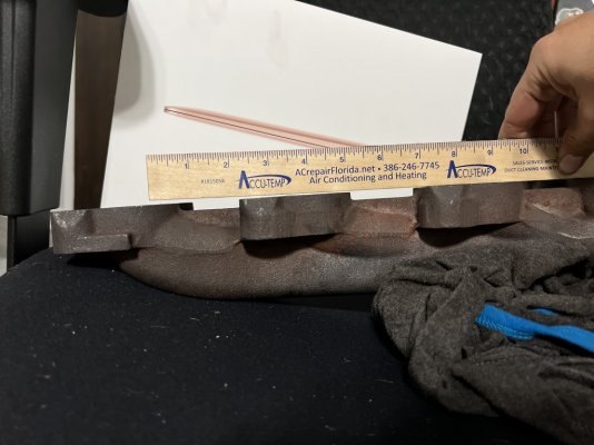

When the exhaust manifold bolts broke on my '15, my tick didn't totally go away when fully warm. Those exhaust manifolds can warp crazy, mine were twisted at the rear cylinder on both sides.

Look what I found this is the side I hear the tick.

Looks normal.......lol:Big Laugh:
Any broken bolts? What do the exhaust ports look like? You should see scorching where the leak is.
My '15 broke only the top rear bolts on BOTH sides, but they had warp and twist to them.
I wonder if the cylinder deactivation in the Hemi has anything to do with how the exhaust manifolds warp.
Have them milled flat, get some Remflex gaskets, and hardware if needed (I used Everbuilt from Amazon), and you'll be good to go.
Thats right. Now that they're heat-warped ...they won't re-warp once milled. (new ones will eventually warp on you ..so get yours 'leveled'. Might want to check the other side.
Its a lot easier/cheaper fix than an engine tick...
Imma get this one milled then eventually swap them out for jba headers I’m just making sure I don’t have a lifer tick

MarcoFuc...Do as you wish, but understand what is being said.... If you have these milled then they WILL NOT Warp again and you will never deal with this issue ever again.
Now if you are planning other power upgrades then appropriate headers for the planned upgrade is worth it. But a stock motor with out any power upgrades and putting on headers is mostly just lips stick on a pig.......
My understanding is the even the aftermarket headers for these trucks have a tendency to warp/snap bolts as well... Do a search I think you will find this to be the case as well.
PS, I was not aware of the milling aspect. I have only 30K on mine and have had bolts replaced. I am thinking next time they are in I may pay to have them milled verse just new bolts installed as is all that the dealers due.
Oooooh okay I see what your saying, if that’s the case then I see no point buying new headers but my issue might be finding a place that would do it, where I live. I’m in the process of trying to find a place
Don't believe everything you read,a set of 1.75" long tube headers and a decent exhaust are one of the best mods you can do to these trucks,and i honestly haven't heard of anybody breaking bolts after going to long tubes .Being a 13,your truck is easy to tune for even more gains from a set of headers.Guys who say there's no gains from headers haven't ran a set on a 5.7 truck.The factory log manifolds are basically a peanut port manifold,and really restrict exhaust flow.Don't even think of a set of shorties,you want long tubes,as they generate more bottem end torque then shorties do,and pull harder all through the power band.
I sanded mine on a belt sander, I did not get them perfect due to the aforementioned warp and twist. but got them good enough that they have 45k miles on them since the fix. All is well so far.
Plus, I used Fel-Pro gaskets as I had already bought them before reading about the Remflex gaskets. Remflex are supposed to be top-notch.
I have the fel pro gasket currently on the one I just took off but I guess it warped enough for it to bleed yet but yet again idk if that was my tick until I get that manifold fixed and back on there and start it off hopefully that’s all it was

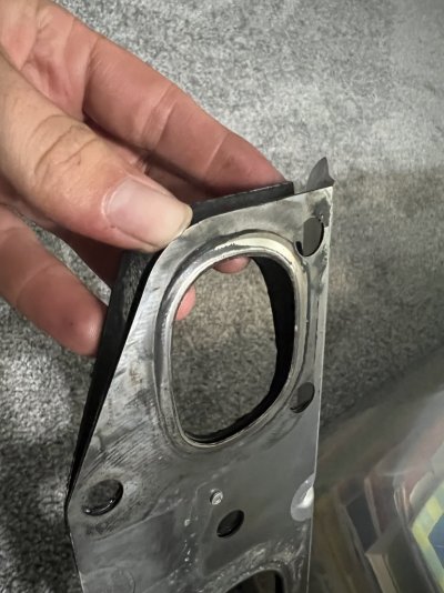

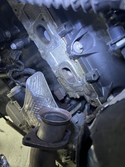

What did the exhaust ports on your cylinder head look like? Any scorching? I would replace the exhaust manifold gaskets as well, just because. Did you have any broken studs?
I’ve ordered new gasket, and to be honest no broken studs just a warped manifold. I mean to be honest some sort of scorching but barely I wonder if it’s cause I barely drove it when it started ticking

That really doesn't look that bad. Clean the head up with a scotch brite pad, put a new gasket on when you get the manifold trued up, and give it a go.
Do I see red RTV?
Do I see red RTV?
Okay, I’ll keep ya posted should have it back together by this weekend. And that I do not know, it might of been already pre threaded on the new bolts I bought last time when I changed them.
