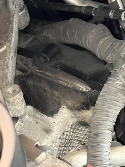

9743ACD7-D1F0-4300-A7CA-9B73F3818A73.jpegI would put the stethoscope around this block and even further down I don’t hear any loud tick? But the only time I really tear a tick is on the exhaust manifold bolt in that front part the first 2 studs
EdGs
Nov 29, 2020
5,681
12,030
FL
When the engine is cold, reach in through the wheel wells, grab the corners of the heat shields, and see if they are loose. If so, broken bolts it is.
You can have a bad enough leak that it does not go away when the engine heats up because the exhaust manifolds can warp alot.
