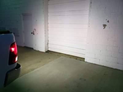

Back up to a window or the garage door at night and you should see them that way.

Sorry to hear that - I don't have a solution, I know I love the Luyed reverse lights in my '17, lights up the drive way like I have headlights back there! I replaced the cargo lights as well and they are great.
Hopefully you can find a brand that works with no errors.
