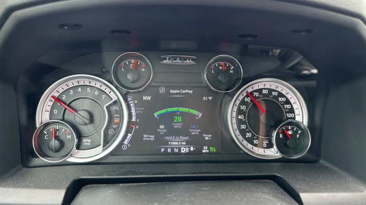

The ole foot off the gas going down a hill picture of the cluster lol. I can get mine to sometimes show 99 mpg lmao
Ha! Love seeing how high I can get only to plummet right back down to reality.
The picture is cruise set, AC off, flat ground and .028 inches above sea level. As good as it gets in a single cab.
You need to cover up that 16.1 mpg average on the next pic,lol.
I can pull over 30 mpg out of the wifes 6.4 Challenger on a decent drive,while she's lucky if she gets 22 mpg out of the car on the same drive,i've given up trying to tell her how to drive for milege,as all it does is bite me in the rear,lol.
