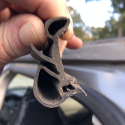

If this part is the body to door frame seal that has a foam bulb on one side and a J-channel reinforced with metal on the other it comes in a generic form. While the generic version may not have the pre-formed bends it can still be used on most vehicles. Possibly stop in a local body shop and ask what they use when an OEM seal is not available.

Is it a seal around a door window or a seal around the door ?

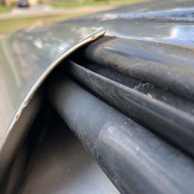

Seal attaches to pinch rail on body along the top of both doors. The top of both doors shut against the seal. There is a bubble above and below the J channel

Rockauto.com has listings for other parts in that vintage. You may have to investigate other alternatives that are a close fit.
I don't know if this is exactly what you're looking for but they list a Mopar 55277030AC.
Their site has detailed listings with lots of pictures.

Another aftermarket listing for that part but it shows that it fits either side so it will probably be different.

BTW , have you checked that the door is not bent out?
