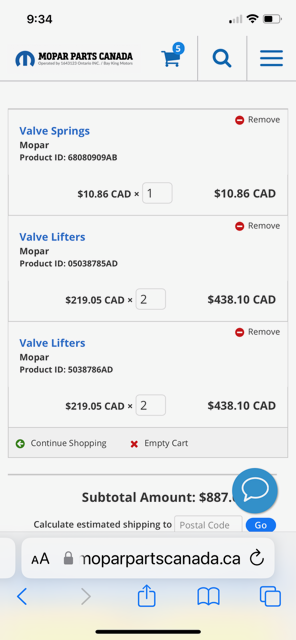

Good morning, I have all my parts ordered now. I just ordered new lifters and spring from mopar parts Canada, they should be delivered in roughly 4 or 5 days. In the meantime I’m going to go over the video’s that you sent @Wild one so some of the questions I’m going to ask I may find in the video’s. But here’s a list of things I need to know, some more important than others. 1. Antifreeze, what kind should I be getting? I will check again but the stuff that came out looks like it may have been orange at one time, I see Valvoline ZXEL1, at RA, I think it said orange dex cool but will have to double check. Actually I will find this information in owners manual, 2. ASSEMBLY LUBE , what kind should I get? I see engine tech Zmoly5 at RA but I hate to order from RA if that’s all I’m getting, it says molydendum disulfidr with 2500ppm Zink, or something from Napa? 3. The new lifters, should they be soaked overnight? In regular engine oil or? 4. Should I squirt a little engine oil down the holes in the pushrods? I was going to apply assembly lube to the cam lobes, lifter rollers, maybe a dab where the rocker meets the valve stem? The assembly lube from RA I mentioned comes with a brush just like antiseize so it must be thicker than the Permatex ultra slick from Napa which is more like a liquid. 5. PRIMING OIL PUMP, I will need to check this procedure if it should be done? I didn’t take oil pump off? 6. EGR SCREEN is dirty, I will get a picture of it, wondering if that’s normal and if I can clean it? 6. TORQUE ROCKER SHAFTS, I will look at the video’s again but I seen in another thread that each cylinder needs to be brought to TDC while torquing the rocker shaft? I will get to searching and reading myself and hopefully get some of these questions I have answered, 7. LOCTITE, no Loctite anywhere right? 8. CLEANING, a little debris got on the heads while taking them out, what’s the best way to clean them? I was thinking just some brake and parts cleaner and compressed air? with some new cardboard beneath while cleaning and repeat? 9. GASKETS, all gaskets go on dry? They all seemed dry when I was taking them off….?

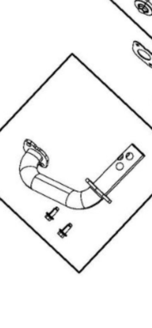

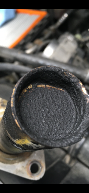

IMG_3045.pngIMG_3042.pngParts should be all in this Monday or Tuesday, I’ve spent a bit of time this weekend going over different things so I have everything in one spot. Just have a couple of quick questions. This egr pipe, can I clean it with brake and parts cleaner or should I get some egr cleaner? And I’m a little worried about working in the garage I’m working in, even with the wood stove it never gets warm in there, basically just keeps me out of the elements and takes a bit of the chill off. Should I be worried putting everything back together in these colder temperatures as far as torque is concerned? When I’ve rebuilt snowmobile engines I have always gotten my shop to 20 degrees Celsius a day or so before I start putting it together but that’s not possible where I’m working in this.

EGR cleaner in a spraybomb works good to soften up carbon. As long as you're not freezing to death working on the truck,you should be okay.I've had to repair trucks in the bush at -40 and as long as i can stay warm enough not to freeze to death,i've never worried about putting them back together,lol
