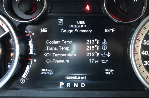

I have a new-to-me 2014 ED quad 4x4. I’ve read various threads on transmission temps that suggest 185 degrees F is a good average.
My temp at highway speeds (no towing) range between 210 and 215. Highest I’ve seen is 219.
Is this within the expected operating range?

They will say yes, however it is above what most people see - you probably have a bad thermostat in the block on the transmission. At least what I see with the hemi 8 speed setups.

Any record on last Trans fluid change? If not, you could probably assume it's original since new. Higher Temps are definitely a sign of fluid break down. Only suggesting since you showing a 132k. Fluid change may be the cheapest and easiest solution since it new to you.

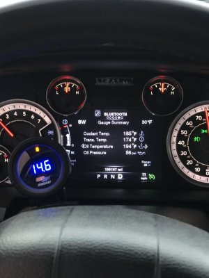

Trans runs ~175 in the winter months, probably start with option 2(removing the valve) next spring once it warms back up and compare aggressive running temps. I do like the heating feature for commuting all season, so we’ll see what the real world results are on the plate.
Wow 175? Nice, I wish I was in the 170s. I run between 181-185.
I wonder how much cooler the number 2 option is? Be nice if that was a solid 10 degree drop, I'm like you where I like the idea of the thermal management system for daily driving/commuting but have it run about 10 to 15 degrees cooler.
shutters are still fully intact too, Milodon 180 coolant thermostat. Photo taken at the end of my 40 mile commute

Not sure how fast your running or do you have the winter front on? All the temperatures are elevated from where most run except the oil. I'm usually 204°F coolant, 185°F-192°F trans, and 212°F oil. My trans while towing usually gets up to 200°F even with 8K lbs behind me.
I mentioned the winter front, most can get away with running it when the temps are in the low 40°s, the manual states 32°F also there is not about a 10°F difference between the oil and coolant. The transmission cooling is done by the top couple of rows of what is also the AC condenser
If the winter front isn't on, I would be thinking thermostat and/or water pump. Make sure the coolant level is at or above the seam in the degas bottle.
