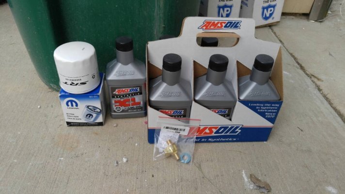

Oil change time!

Cleaned this sucker out too.

Is that filter bigger than a standard filter?
Yes sir. Here's the filter with the part number.
I have no idea if bigger means better, but I've heard from a few people it's as good if not better than the other high quality filters out there and it's $13 on Amazon.

My thought on the Bigger subject is----->More filter media means more filter area to filter the in coming oil. Which can't be a bad thing!
My only concern would loom in the direction of a change in oil psi.
Higher psi would be better / Lower psi might be a bad thing.
I have read where the SRT oil filter was designed for more flow.
Take that for what it is worth.
Aggressor: Let me know how much of a pain the larger filter is to install around the electric power steering unit. As well as uninstall. Thinking about going to the larger filter. Would make for easier filter buying since my sons F150 5.4L 3V would take the same filter.

I agree, can't be a bad thing. As far as oil pressure, my idle and driving oil pressure were all pretty much the same. The filter wasn't a pain to install just had to tilt it a little to get it into place. When it comes time to remove it though... Unfortunately I will have to tilt it again to get it out and oil will go everywhere. I hate the filter location on these trucks.

Why the smaller filter then? Is it a clearance issue anywhere?

My truck is a 13 with the electric steering but was manufactured in Dec 2012. It came from the factory with the bigger filter

Sorry for my ignorance. What's the fumoto valve for?
