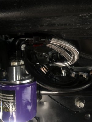

With oil drained and filter finally removed I get ready to install my relocation kit. Most kits include 90 degree connectors on each piece. I didn't want that nor were hoses able to be routed on the Ram with 90's so I pieced together my own kit using Perma Cool parts. All made in USA. The single filter mount allows larger, better filters.
So looking at your setup do the lines slope down? It looks like your adapter and filter are now in line. On my 2013 the filter sits WAY up. Like atleast 12" up from the underside of the truck. Yours looks much closer. Maybe the pictures are deceiving. I didn't think they changed the HEMI but ¯\_(ツ)_/¯
My filter was way up too. I have a 2017.
My setup the oil lines are inline with the engine adapter.

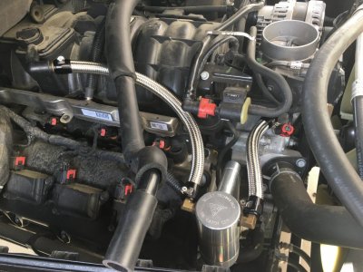

Probably. That’s essentially what I’ve got on my catch can. The only issue might be the PSI running through the lines would require something a little more stout than just a clamp.

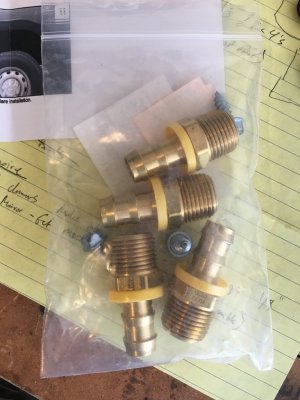

I will add though, in the TransDapt kit all it comes with is barbed fittings and hose with no clamps whatsoever.

@TXCOMT Just buy the kit and install it as is with the addition of hose clamps. If you want “cool factor” with braided lines and AN fittings, spend the extra coin and get quality name brand kit, not no-name Chinese/knock-off line or fittings. I will say you should use ARP thread sealer instead of the Teflon tape on the brass barb fittings (I posted a pic of them previously) I had a leak from that and once I swapped to the ARP sealer, it fixed it.
https://m.ebay.com/itm/ARP-100-9904...Stud-Sealer-/321341783800?txnId=1896620634011
Don’t be fooled. The picture makes the tube look small but it’s actually pretty large, and even “used liberally” as it describes in the instructions you don’t use much.
