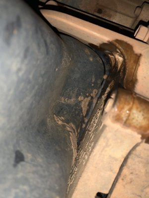

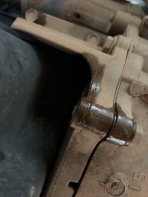

I have a oil leak I believe it’s coming from the oil pan near where it meets the tranny. How difficult is it to drop the oil pan my self

Maybe I'm not interpreting the pics correctly, but that doesn't look like a pan leak to me. It may be coming from above, like a valve cover gasket leak, etc.

I was getting ready to post the same thing. From the pic it looks like oil is coming down from above.

With those miles could be a rear crankshaft seal too.

Hope it's only the pan gasket, or other minor repair. My 2019 developed a leak in it's first thousand miles. It turned out to be the main seal. Took two days at a dealers to pull the crank down and replace the seal. I hope you've already resolved it.

I was thinkin rear seal also..anytime I see a leak in that area thats usually what I'm thinkin....hope not tho.. PIA job to fix.
