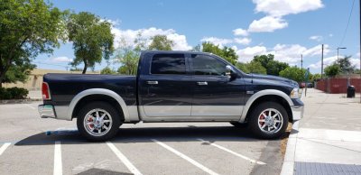

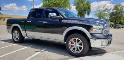

So i finally got around to it, went to order the CFT Level Links only to have them tell me they don't ship to California! Wtf! Anyway in searching I came across Supreme Suspensions in LA Mirada CA. Pretty much exactly like CFT in looks and price. Ordered those via Paypal only to find I had $43 there I'd forgotten all about, sweet! Got em in a couple days and installed them, quick and easy. Had to mess with them a couple times as the left front was down an inch from the right, easy to adjust out. Settles on 1/2" less than the rear, all settings still function. Doesn't ride any different that i can feel.
