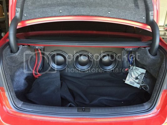

Yes I have. My friend Jerry Niebur just became a AF rep about 6 months ago. He did an AF install on his wife's Honda Pilot....I like their components alot FTR!
Now we are currently in the middle of installing three AF10's in his TSX.
They sound alot like the Esotar1200 but with much more output. It's a juicy subwoofer....you gonna likey

Three audio froggy 10's
have not heard them yet....soon tho
Ooh that looks like fun. Plz hurry and listen and report back.
