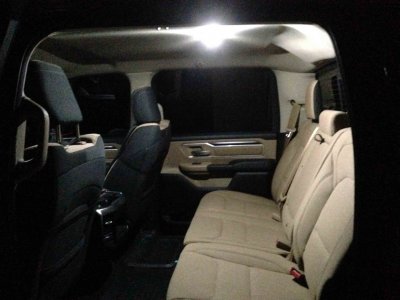

Yup, well I changed out all of my interior bulbs to LED, what I used for all interior except for dome light, which takes a festoon led:

Canbus doesn’t monitor interior lights. I used extremely cheap led from amazon, not canbus and have no issues at all. Many on the forum have converted to led inside with no issues.
Absolutely no issue on MY 19 Bighorn DT: (ALSO had no issues in MY 15 ED when I had, but putting lights in Upper Console on MY 19 was a MONSTER MAJOR PITA)
LED FESTOON DOME.JPG LED Interior.JPG IMG_0798.JPG IMG_0799.JPG IMG_0800.JPG
