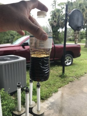

Use a catch can. That way you keep a vacuum sucking the goop out and don’t turn your oil to acid. I drain mine about every 2k miles and get about an ounce or two out. If you do oil changes every 3k then you may be fine. Water and fuel vapors mix into the oil and turn to acid if not sucked out first

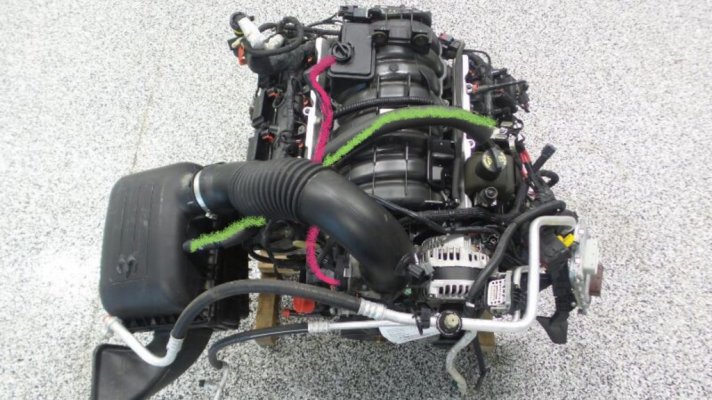

Is there a diagram for the 5.7 PCV system?
I haven’t found one yet.

some one help me out and explain which direction is each hose ?
Pink one is the PCV hose you'd plumb a catch can into,the green hose is the crankcase make up air hose.The green hose you don't need to worry about,it stays in place to let filtered air back into the crankcase,when there's vaccum in the pink hose

Which direction is the pink hose air going ? Back to the PCV or toward the throttle body ?
I’m guessing toward (behind) the throttle plate …
