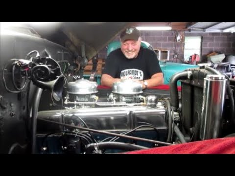

All engines have a combustion chamber, in that chamber pressure & heat build up & that pressure needs to be relieved, originally on the side of 6 cylinder engines & the rear of a 8 cylinder engine, they used to have a Road Draft Tube,
This video beginning around the 10 minute point, this gent is converting his 6 cylinder Chevy truck over to a PVC system, he has to remove the Road Draft Tube & does a fair job of explaining everything
I don't know about you, but that video brings back many fond memories :)
