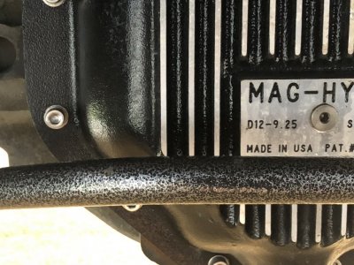

Can you snap a pic for me?

sure, lemme wipe it down with some detail spray and I will be right back...

Here ya go. Mag Hytek diff cover behind it is black for comparison.
Thanks! Did it always look like that or is it worn? May be able to live with it... First world problems lol. If it looks black from a far, I may deal with it unless I can make it to the powder coated Thursday before they close.

Always like that.
