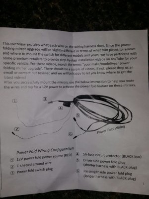

I decided to order the harness from 1A Auto to add the switch. I'm trying to figure out if it will connect to the OEM mirrors because 1A Auto has their mirrors in production with no idea of when they might be in stock.
Here is the wiring diagram that came with the harness.
Sent from my SM-N920R4 using Tapatalk
TW15TD
Mar 10, 2016
26
V8
The 1A Auto wiring harness is not plug and play with the OEM power folding tow mirrors.
