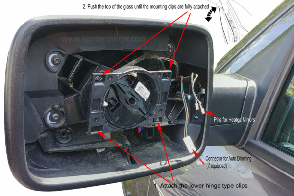

Something that you might try
There is a panel in the mirror housing
go to Harbor Freight or Auto Parts store & get a set of plastic trim tools, there are many places to use them on our Rams
Then Being very careful, find a place to pry the cover plate off
If money is tight, use a straight slot screwdriver & wrap the blade with tape to protect the plastic
This is from a NON power folding mirror, but i think the mirror pivots on something like this
Maybe spray some Silicone on it

Your mirror is easy enough to disassemble
The tricky part is removing the mirror glass
not power folding type
