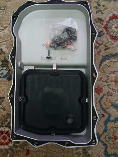

Okay. Got my PPE pan, new screws, bought a new gasket, fits nicely. Bought a chemical sprayer as transfer pump. tools ready. Plan to do this tomorrow. From videos I've seen I notice the stock gaskets seem to have a metal sleeve. Do I transfer those over to new gasket/pan?

Most guys do. Have you got some tall jackstands as you need the rear of the truck in the air a fair height to level the transmission. 3 ton stands usually aren't tall enough.

If you're talking about the metal sleeves for the screws in the old pan, I would transfer those to the PPE. They will keep the gasket positioned.
Remember to crack the fill plug loose BEFORE draining the trans. Those fill plugs were all tightened by Hercules, afaik.....lol.
Good luck, may your service go smoothly.

Thank you sir! Gasket seems pretty thin in certain spots. It's fel-pro brand. Not sure if the mopar is the same. Will see.

Some have said that the sleeves are a lttle tight in the holes of the PPE pan, might wanth to have a small round file if needed.
A little snug is good for the sleeves, that way they wont fall out, as long as they do not get misshapen transferring them.

I installed a PPE pan on my 3.6 and transferred the metal sleeves from the OEM pan. They are a tight fit but very doable with a small block of wood and mallet for the stubborn ones. Follow WildOnes directions and it’s a fairly straightforward procedure. One more tip you may consider is chasing the threads on the pan rail. I live in the southern US and still had some corrosion that would impede the bolts when installing. You’ll see when you remove the old pan that the threads do not bottom out inside the pan rail, they go through it and are open to the atmosphere on the back side. Hope it all goes well for you.

I used the metal sleeves, just had to ream a few of the holes in the PPE as they were very tight.

I ordered a new aftermarket (fel-pro) gasket to use with my PPE. It's been several months, no leakage issues yet. Though to be honest the original gasket was in great shape, I'm confident it would have worked fine. I tightened by feel, was very gentle. Almost 4 months, so far so good.
