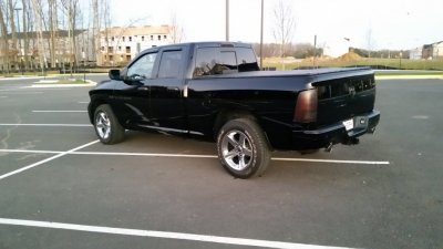

Hey guys new to the truck world just bought a 2012 ram 1500 sport. Installed CAI SB and cut the muffler off and put a y pipe. Since I put the y pipe noted the throttle response hasnt been as good has Id like it to be. So my question is should I buy a chip and if so which ones are recommend and do they have maps for simple mods CAI and muffler deleted kit. Or should I take it to the shop for a custom tune only thing with the shop is they do not have a dyno so I take it they're going to be doing street runs which I'm not crazy about. Also I'm curious can you fit a throttle body on if you have a CAI if so what make BBK or so and what size. Thanks Guys
