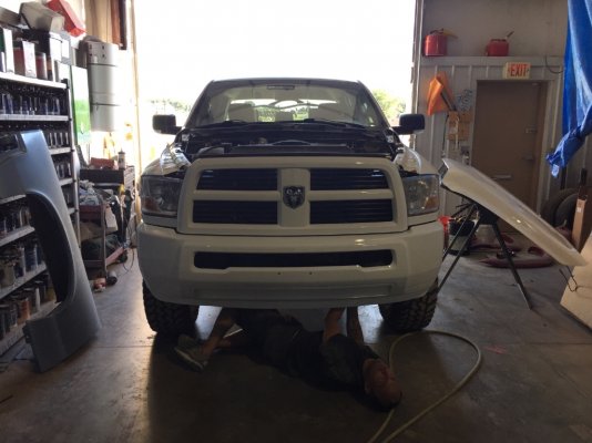

I got a new grill and it did not come with a seal. Does anybody know the part number or what the seal is called that goes on top of the grill. It is the seal thats fills in the gap between the hood and the grill. i have tried google and ebay and could not find anything. Chrome is the orginal grill and new grill is the factory color grill

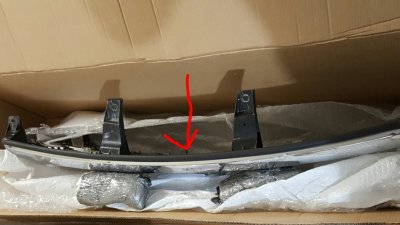

beachbummer0069
Jul 1, 2010
12
Yea, the seal is glued on to my chrome grill

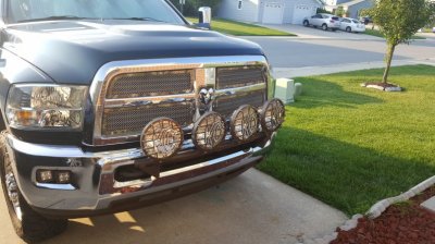

Hootbro
U.S. Army Veteran
Army
Jul 31, 2015
2,881
2,269
Delaware
2017 1500 Express 4x4
Pentastar 3.6L
What light bar mount is that?

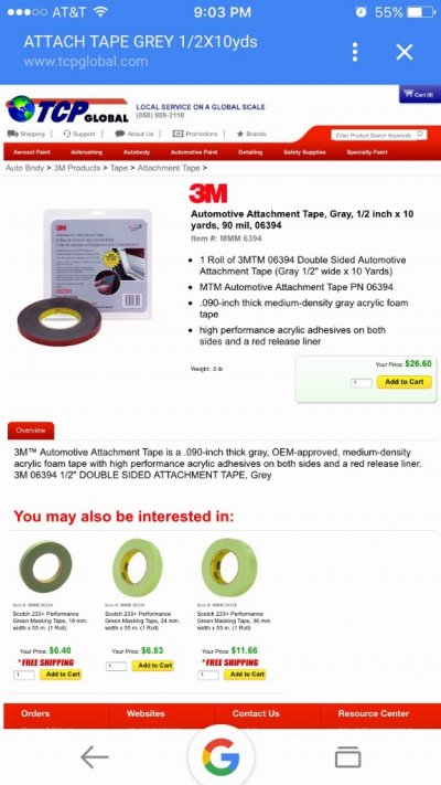

82Crew
Oct 10, 2014
220
153
North of St. Louis
1982, 2010
318 Magnum, 6.7 Cummins
Use a razor blade and pull it off old grill and get double sided foam tape and tape it back on, that's what I didf4d351b5f6ef61c6ac9c07cbbbd47cc0.jpg
