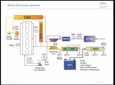

DEF is injected post-DPF in all diesel after treatment exhaust systems. The fluid is injected into the Selective Catalytic Reduction (SCR) to reduce NOx.
DEF is not on every after-treatment system. Cummins didn’t have it from ‘07.5-‘12

Not quite. Myself and a number of others have had issues with the DEF system. Defective pumps, quality sensors, etc. that make the truck undriveable when they fail. Pumps have been on national back order for over a year. Also the DEF/SCR system is before the DPF in the exhaust system but it is not some exhaust system janitor. The catalyst in the SCR breaks down the NOx into nitrogen and oxygen. The DEF is a catalytic reaction action enhancer which is used up during the process.
Yes I misspoke, DEF is sprayed before DPF.
I’m aware of what it does, however the DEF-equipped system is far superior than non-DEF used from ‘07.5-‘12. By every metric, the DEF system is better; it’s more reliable, it’s got better fuel economy, far more power, etc. Yes, everything can fail and will eventually, that doesn’t mean it’s not better.
I should have qualified my initial statement of diesel exhaust systems
that use DEF, but didn't think I would need to if a truck doesn't use DEF it doesn't have to spray the stuff.
Your both wrong, the SCR is after the DPF, so that makes it downstream and that's where the DEF is injected.
The DOC is located before the DPF and does not require DEF. In the Cummins exhaust there is a separate DOC located in the downpipe, other diesel exhaust systems have the DOC and DPF in one.
The DPF is #9 the SCR is #10

I stand corrected. Thanks for the diagram Crash.
Which makes a guy wonder what in the world you were initially trying to say when you quoted my original post. I’m still scratching my head on that one....
I did twist myself this morning. Of course DEF is post-DPF. Like I originally stated correctly. Has to filter before you can convert...
