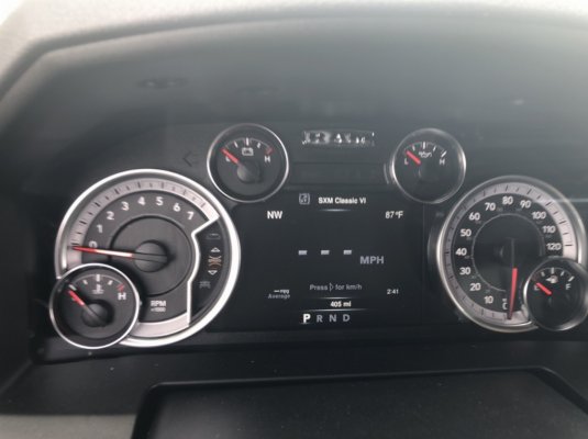

Have a strange one.
While in Acc on sat radio volume will suddenly increase then a few seconds later go back down.
Dash while on normal volume
Dash when it jumps up in volume
Dealer has to go through diagnostics before they get the OK to replace the head unit.
2019 Classic 400 miles.
Anyone else have this annoying glitch?

Check the speed compensation setting for the volume(it's in the radio settings), try turning it to off. Depending on where it's set at, the radio volume will increase as the vehicle speed increases, this setting is handy for people who like to drive with the windows down.
The radio probably can't interpret the - - of the vehicle speed. The speedo reading probably does that because of the BCM shutting down.

I have it set on 3. I'll try turning it off. Thanks
