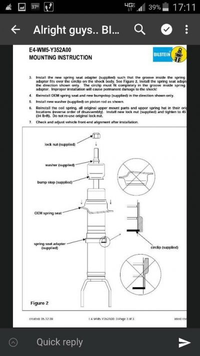

Check out my install post on this link . I believe it's #26 ?
Look at the important message about the washer placement , and how I installed the top nut with an elect impact.
Hope this helps !
http://www.ramforum.com/showthread.php?t=79370

What RLK said above ^^. Where did you put the washer when you assembled the Bilsteins. If it's up against the nut on top of the upper spring hardware that's incorrect and likely what your issue is. The washer needs to go on the shock rod BEFORE the upper spring hardware goes on.

Hey buddy , just to clarify things . The nut is not the issue here , and the nut will not wear a hole in the top , the issue is the placement of the washer .
The washer is supposed to be installed under the threads on the top of the piston , then install the upper spring housing assy , and then the top nut last .
The reason for the washer placement is because the Pistons diameter is slightly smaller in diameter that the oem shock assy diameter, the washer makes the bilsteins piston the same diameter on top as the oem shock .
If this is not done properly the smaller diameter bilstein shock piston will eventually wear through the upper spring housing assy.
Read the notes !
