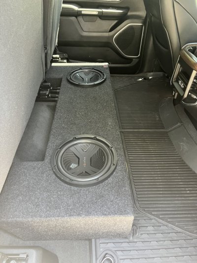

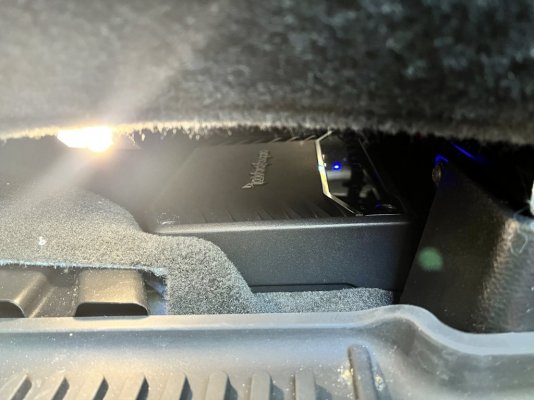

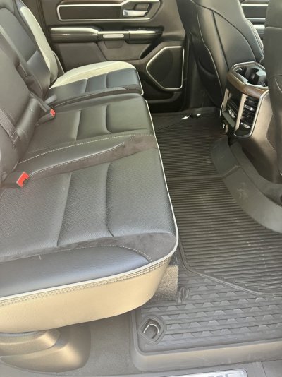

What subs and amp did you use? Any pics of the install?
The subs are Kenwood Excelon, and the amp is a Rockford Fosgate 500w mono. The amp is under the passenger seat.
