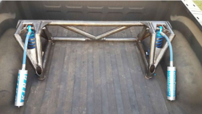

LMAO this forum is going to make all of us go broke. All those 0% CC offers are getting harder and harder to ignore. I still can't stop fantasizing about coilovers for the rear.
You of all people should do that. I'd love to see the bed cage you come up with....hint hint. I call dibs on your old chit [emoji16]
