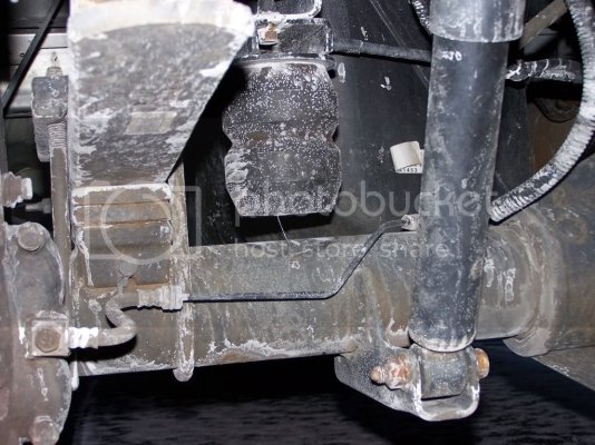

As far as I know the timbren replaces the bumpstop and acts like a progressive spring, with more weight applied it will become stiffer(as its compressed)
Unloaded your truck should ride like stock. 450lb might not be enough to compress them down to the axle but that would also mean you aren't sagging much!
I found these pictures and it looks like you might have to modify them to work with the lift as well
You would probably have to add a spacer as thick as your lift block
Amazon seems to have the best price on them although I didn't look very hard cause I'm on my phone and can't sort by prices
