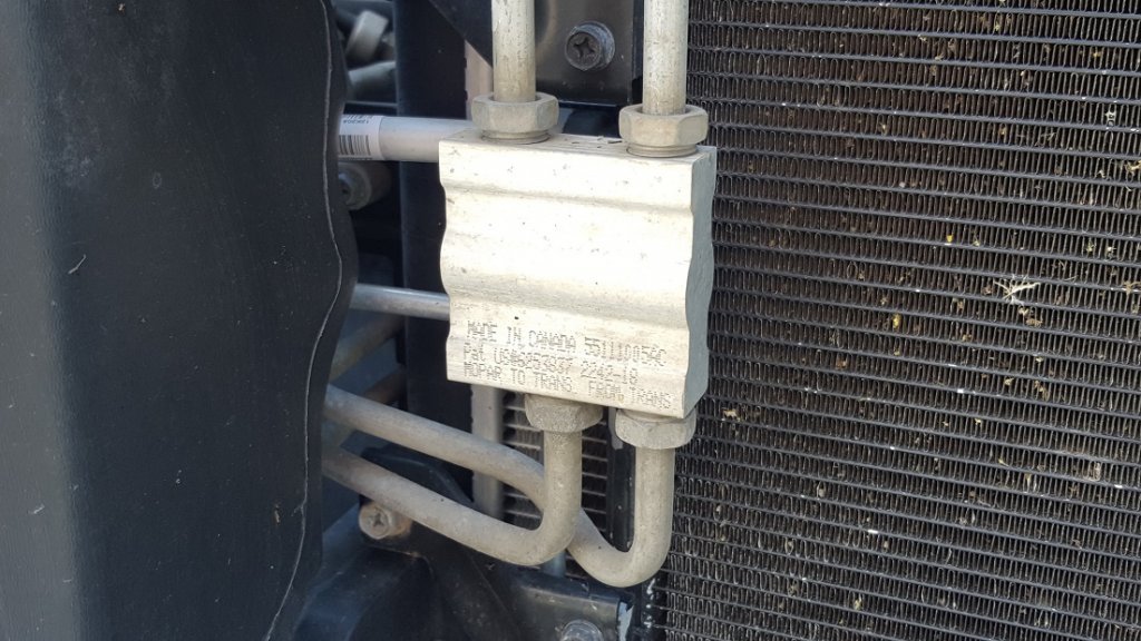

Great info. It's cool that a delete kit is available now. It looks like that would work on a 1500 with the 65RFE as well. I bypassed the TCV on my '13 1500 with 65rfe a while ago and temps never go over 120* unless I'm towing. And even then they never go over 150*. I did install an aux trans cooler though. Here's the OEM bypass on my truck.....

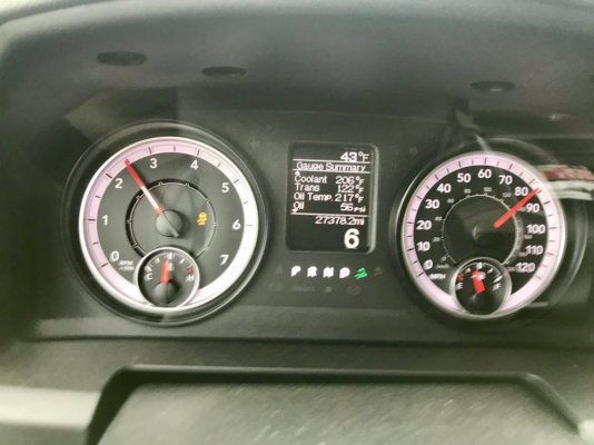

Thermal bypass delete done.
Thanks SYN for creating the thread and thanks again to AFM for making that install video.
This is at the end of driving a true 80 mph for about 40 min
