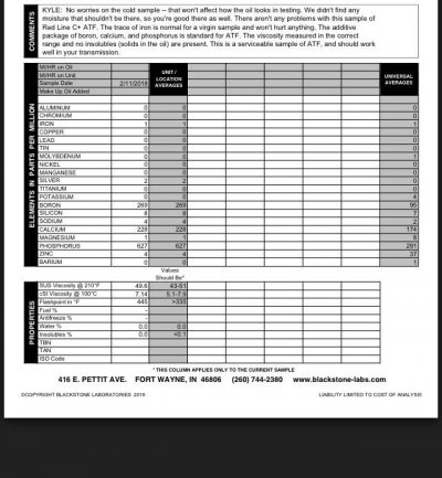

The key word there is "recommended". I've had C+ in my 44-44 for about 6 months now and it works perfectly. No clutch slippage, no noises, nothing. I did a VOA on this and Dexron III awhile back and the add pack of both is a little different but the viscosity and all the other properties of them is identical. The Mopar 44-44 is actually closer to an ATF+4.
@U&A did a VOA on Redline C+ a while back also so here's the two VOAs. The only major difference between the two is Boron and Phosphorus...1e97d538e53f312eb0a135ff50a98373.jpgc24a3a38756a3513a11d6bf2ce4f528f.jpg
