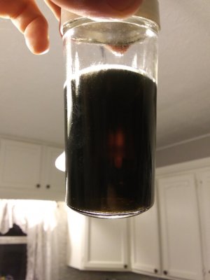

Fluids(all changed to redline) that i have changed on 2017 crew cab with 30k miles currently.
Rear Diff 75w140 , ~2.5 quarts :
Front fluid 75w90, ~1.0 quarts:
Redline D6(8 speed) - drain and fill ~6 quarts - fluid came out really dark.

I noticed transmission slippage during heavy acceleration(with zf fluid). My truck is custom tuned and I drive very aggressive. After the drain and fill the problem went away and noticed firmer shifts.
I leveled the truck to try to get as much fluid out and let it drain for a couple of hours. I defintely plan on doing another drain and fill sooner rather than later. I cant imagine the original fluid lasting a lifetime!

Wow. How many miles are on that fluid? I just drained a bunch of mine on accident (sawzall accident when cutting cross over pipe and composite tranny pan) with 15k and the fluid was still clear.

Yes the oem is a tint of green, this is a bad pic I've seen others, but you see the hue and the clearness.

Guys i push my truck to the limit, the truck gets driven more like a sports car. The scenerio Im about to decribe is not normal for most.
Took a road trip to las Vegas(driving from Texas), and decided I was going to try to keep up with a Jeep track hawk speeding through a Valley(I had already been driving for hours in the heat). The transmission temps were getting hotter and started to notice slipping . afterwards both my tuner and i were trying to figure out why. As a last resort I decided what the heck, change the fluid. I do believe that heat can cause the fluid to fail, and is why now with the new fluid Ive noticed smoother shifting.

Funny you ask. I´ve been contemplating of what my next step would be. I would love to flush all the fluid but the transmission is so complicated. I had a hard time just getting the drain plug off.
I feel more comfortable doing drain and fills till my fluid looks better. Just to see if the fluid is getting cleaner with changing it. I do diffently recommend changing that pan (since it has magnets and filter integrated)but its costly.

I had to refill almost 9 quarts by following the drain/refill procedure (yes, that hurt my bank account!) by pulling the pan, and also pulling the transmission cooling lines going to the combo A/C and transmission cooler when I removed the unit to do my cam swap. By draining the cooler, draining lines, and pulling the pan you get quite a bit and letting it drain over a day or two seems to pull a good bit out, I think the total capacity is around 12 qts?
