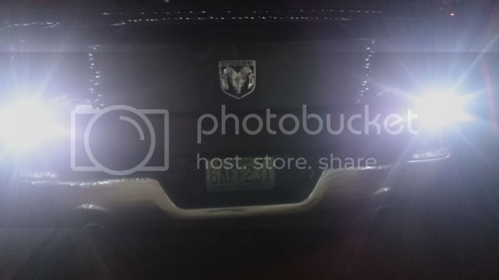

Just played with the existing holes with some brackets. Ill take pics once it stop raining . They do work well at noght

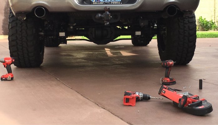

this is what I want to do on my truck.....Just looks very clean

20.00 pods from amazon

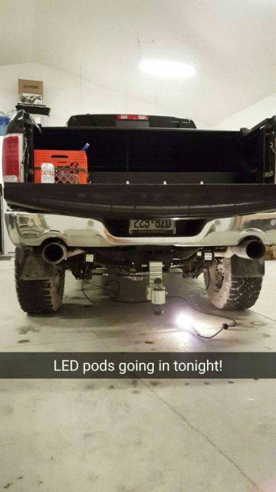

I just drilled a hole through the hitch and bolted mine on. Connected them both together with solder and heat shrink tubing, then ran them to the passengers side tail light. I tapped into the reverse light wires and they work perfectly!

I took one of the taillights off and used tap connectors to tap into the positive and negative wires going to the reverse light on the taillight.
