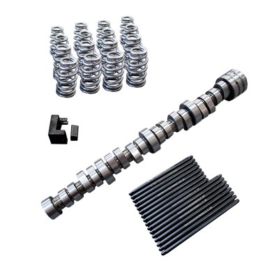

I 2nd that. The 2500 cam would only be useful if you're pulling heavy day in and day out otherwise you're downgrading on power. The Challenger non MDS cam would be a better fit and those aren't light cars so it will still have plenty of grunt to get the Ram moving around. Since you'll need a tune either way a custom grind mind be the way to go depending on pricing. Typically the all inclusive package deals are the best bang for your buck since they'll come with new lifters, springs, pushrods, and the cam if you want to upgrade over the OE stuff.
Interesting but good to know as far as the challenger cam being a better upgrade. Thanks for the info! And the tsp cam deals are a great price point compared to some
