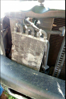

Hi bros :)
i am searching ... this time ... an oil cooler at rock's store.
I've seen it thousand times ... even the small parts to fix it ont he body ...
now i wish to order it ... NOWAY to find it back ... at same time, english isn't my first language .. witch will probably not help ;-)
basicaly, it is for a 5.2 4*4 from 1998 4 doors gen two, the price was very low ... Something like 18 bucks
There is no leak ... BUT it is so crap .. don't want to let it on my truck
If someone could help me finding it (!?) please ;-) copy paste the link ?

Most auto parts stores have an assortment of different size coolers, just match one up to yours, and it doesn’t have to be perfect just around same size, they all do the very same function, you can go bigger but def don’t go smaller. Most are regular 5/8 heater tubing.

Don’t use heater hose, the hose isnt made for oils. Most auto parts stores have hose in bulk, a couple of those should be for transmission.

Not a matter of the oil, it's the pressure.
Transmission hose is rated for a higher pressure than heater hose is.
When was the last time you blew a radiator hose and it caught fire?
Never?
That's what I thought.
Use transmission hose. Any shop that uses heater hose for transmission line is a straight up HACK SHOP.
