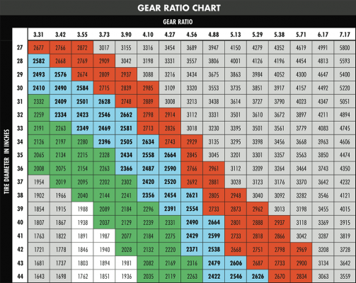

Looking at a size to gearing chart, should i be going off what the supposed size is for a 285-75-17 (33.8in or 2697mm) or go off what i programmed in with AlfaOBD to get the speedometer accurate, 265-75-17 (32.6in or 2604mm). would i round up to a 34in tire on the chart or use 33in tire on the chart. the chart that i am looking at is on 4WP's site and the 34in tire to 4.56 is in the bottom of the red, while the 33in tire is not even in the band. or should i not even worry about the bands of performance/economy provided? i dont believe im going to go any bigger with the tire as with no lift/level its stuffed in already and doesn't rub under normal conditions (i have gotten it to rub when in a turn and hitting a decent bump/pothole). even once it is leveled its still a bigger tire than what was factory and what was installed on my step-father's 2018 Rebel(not by much tho....). even if i did go with a bigger tire in future, if i still did a 4.56 it looks like i'd have some room to increase tire size afterwards without having to re-gear again. sorry if this sounds like a stupid question.
