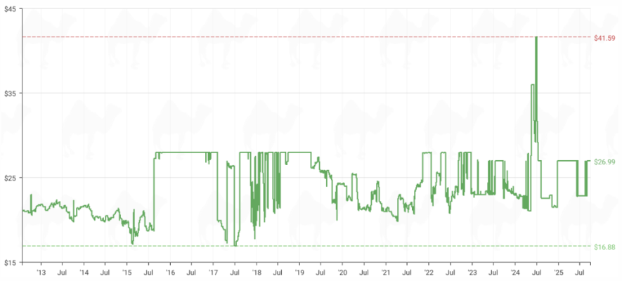

I've been using Lubegard Bio/Tech Engine Oil Protectant from the first oil change on my 6.4. I get the 32 oz. bottle and add 16 oz. per oil change.
It's usually cheaper on Amazon. I get alerts for it and PUP 0W40 and pick them up at their cheapest points. Here's the pricing history of the 32 oz. Lubegard:
