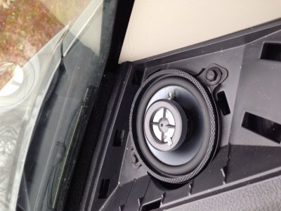

Ended up ordering the ks35's for the dash. Just figuring out the doors.
Also, thanks about cutting the dash I knew about it already but yea. U sure this harness is the one I need?
