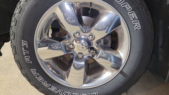

Did your's look like they had the same low clearance levels, the same as the OP's?
I have the 20-inch chrome clad wheels and I just used the 22mm deep socket black oxide for impact guns that I use for all my 2500 and 3500 Chevy trucks. If anything, I think the impact socket is on the thicker side.

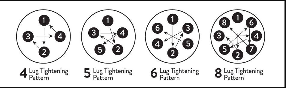

Torque Wrench Sir, TQ to 130 ft Lbs. !!!!!!!!!!!!!!!! TQ sequence also.
ADDED: YUP, it always makes sense to check things that are important and can impact your safety. What size socket did U get?
turkeybird56
Aug 2, 2018
25,562
56,157
Central Texas
and just fer c h i t s and giggles, here is the sequences: Once U have gone through the pattern once I always go back through a second time, just an old habit from playing with Humvee wheels, and something I have done, known for a long time.
