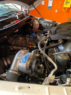

I do mine Every 2 years. The easiest way is thru the wheel wells. Also a 4 lift and 1.5" body lift sure helps a lot :) . Install those first...
EI6HBYkwZG7qtVD4TM15PtaARUuctfFiSa8oLqWeMOyIULRsvZdpSxw21b6vh8_vWlHz4OSz8zqNrOBTkwEd82M0gdxm6CHHYXhPDzqVOUIm0LQLhHLfV-li0juLHMm7Cd1HeueEjhaj5k85J_GtGQSPqHZow9z2POZcqqFr6_6pRCBfi0sX4CtAkwdTXvVEzpJPrwP27QvVw5PWKoSqOziYqIIIXhHMSWL3zdcXtsGDNw4ZX6T60cpX3MykYh1jQbndoOVmtQ9l8FdzvTl8gF3PCGzc9TMi0KSBzoQdJIb_Vzm7QsF3haOk2B2ssQU9mxSIcjvQ0ZzcDiisSiBCniPFDsFkORcxOhhBt5U5Oftyne3TaeQOMDK76wgtKzba2pklvqkKHWr5YIepBSksEkTeaoCMuF4c8J2pBQE13HfkU_qaFMprwGTQrl57G3vh2Va1vqNcK2UTmrTdIOIjTWXnS2jPDio1feE2P4OEytF-oy4lVJpu7fTmoi4ItOt9yTaN4l3vy_lMsxfu1yjGmBngutnKfIqW7U827R2uDAGahhIsymbAKncckTdl4H2xh7yD0j7RsOrbEkeRrjlCxQQOCG4ENwjUq9QV-8XR7mhj3RKQFpPgSxY5FgGaMOr4xVcl0VohURywEDOwfCoRQQKWPEd4KBSFb6vQKmZN-RLFUs_hWCoJ7QL9x9QePg=w1920-h960-no
o9EHpTDhIcU1-DvmnPC-UDff_NtK6DAT3-HGCqRADlB_jwzpxdIeTskmYJHhFtbXiBCztgXP5nosJNevB0yiHJaYw4QnsiuGWo9h7QkGaLs2Wk07qye_xvBENqXdZclTFHiIlm2dedE3HyaDOJ4CDOBhVI3hVnNjJ3-Z4b0dgGwqtmALFBS8BE2zkH46YJl3dCODPD1C7EkvaiQblwIGfYFtEW_CtFlSLD7wldmrSO18l2cctBlGrYP4fWCpSXf-fUm21GDRTY8xm-CMXzrDDqkiH98oCx-qvkomTyhRaGrla3yAJrozUdQ2CHO5wUH0M3yYw7_gfczaYL3_8Bs1t28qrJo5l0pC9wgYOCkQxa7DMLVgh5WGBhvE9JWguoMlGi-6BWhGZkVR_FaaaOqwpVBxsAY2eTeT0FX_kNWYILtSXi0Ga3b67ld3-w7ZIF9h_PpUaVntjGrNqBuxn3yP7g78s-8Nx1ietWfQ5PznhQz-OhoOcSZZotuiCDU3sqV0ZgxAxSX6IhTO2IsZf29vIJr8YrtDg046G6wz17XAN1XLS_3mB4vxNe5jrfudwGXWL9hl81Djf_4IsXV0mJo32eOluUw0wqjOSp1wugHyYLc1Zc64-11irq-ZtOQMQpS2eiXj7FMAOCCrumr11qCXSEe-6mpkzMZzT_FLOkfmY7xUFYsZC5zxJdmWNy2bFQ=w1920-h960-no
