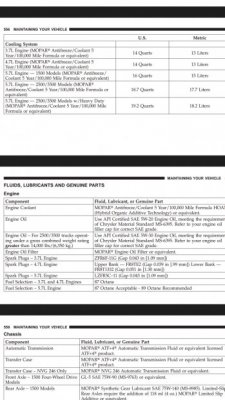

Factory plugs in my '11 are iridium ones. Got 16 NGK LZFR5C-11 iridium plugs at carquest for $96. Parts guy there said in their computer recommended interval is 80k. According to the carfax service records plugs were changed on mine at 30k and I just did them at 100k and could feel a difference. I know they were changed at some point because I pulled out NGK LZFR5C-11 plugs and I know that's not what the factory uses.
Hate to break it to you but the lzfr5c-11 are a Copper plugs and ngk are factory it's what's in the owners manual and in the Chilton I have also.
