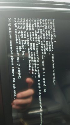

To install it correctly :
You must rename the px6.zip file px6_format.zip
Boot unit fully
Insert fat32 formatted usb with px6_format.zip file into main USB dock (not console dock)
Reset unit
Wait until prompted to remove usb by black Dos screen
Remove usb
Enjoy
Boot unit fully
Reset unit
Remove usb
Enjoy
Before any of these steps it is super important to take pictures of all settings screens as you will have to fully reset every setting from scratch

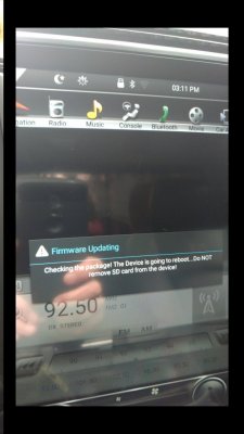

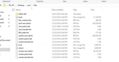

IMG_20191027_151913.jpg PX6 zip file.JPG I was wondering that too....so I grabbed a pic when it was done installing. The file was also named PX6, but their instructions didn't call for changing the file name like you did. I also attached a pic of the files in the zip file.

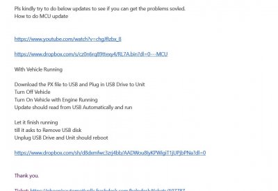

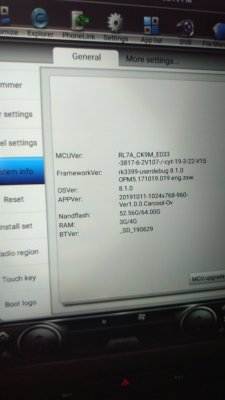

Here's the instructions Phoenix sent...
Identical APPVer.
I had to do the rename because I needed to erase the original FW to properly install the new bug squashing version properly.
If yours doesn't fix your issues. You may want to try the rename method too.
Takes longer to set everything back up, may be required for proper installation
