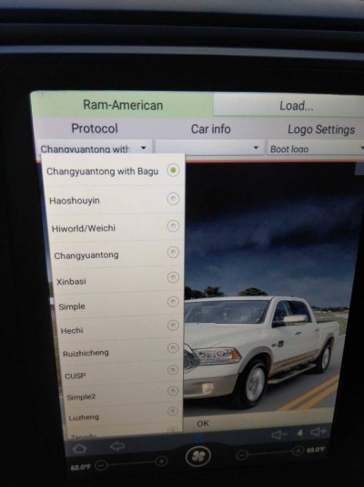

I installed the update tonight... Now, my climate controls don't work at all. Probably just a setting somewhere... I'll see tomorrow if it boots up normally or goes to the reverse screen. Good thing I have other cars to drive tomorrow...with climate control! And, my 30 day return warranty is up on Wednesday. So, if it does boot up normally tomorrow, I still need to ask Phoenix to extend my return timeframe for another week....to see if I can get everything squared away. If they won't do it...I need a return label by Wednesday.

Set your car type and select this protocol. Should fix you...db42c7b3d31d8d9937e6a220c41610c8.jpg
My last was a reply to you @NJ4X4

Thanks!!!!!!!! That was one of the settings I didn't know what to do with. I think I might have left it on "default"

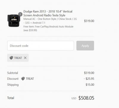

I looked at Rhino again tonight. I can get a one button, 7.1 unit with Android Auto (I assume a dongle) delivered for $508. Not sure what to do yet....but considering this.
