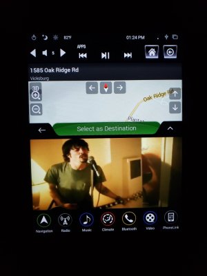

the split screen is nice, you can use GPS and watch videos

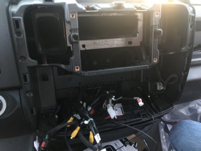

Okay so I got my Tesla style screen(linkswell gen 2 ) installed today After a little confusion with the speaker plugs I figured it out , I also found it easier to route the main harness wires lower (pic ) to fit the bezel back in . There is plenty more room running the harnesses lower . So With all that being said I have a few questions I can’t seem to find answers for in This forum granted I’ve been through 100 pages and am tired of reading mostly the same thing over and over so I decided to just ask. Q.1 When my Bluetooth is connected it plays music but if I hit home screen or any other app my music turns off , and the same happens with The radio app. Is that just how it is or is there a setting I can change ? Q.2 I have the white dongle for the Apple CarPlay , when I plug in my iPhone it charges the phone but nothing changes on screen , is there a secondary app needed to run the dongle ? I’ve tried both USB ports provided with the screen. Q.3 is there a way to update the software or am I locked In on what I have , I believe it was 4.1.1 when I checked not 100% on that

For the music stopping, they are not supposed to. The stock players that come with the radio firmware and a list of other popular (in some countries) media apps are whitelisted to prevent the music playback from stopping as you describe. The stock apps are also included as system apps and protected in additional pieces of code to prevent this behavior. My guess is Linkswell modified the APKs with their own and either didn't add them to these lists and/or improperly added them to these lists. An updated firmware flash from Linkswell may cure the playback issue.
As @SHERMAN ROBBINS stated, you'll need the autokit apk or whichever apk is mentioned in the instructions that the dongle came with. Some resellers like Linkswell may have already included this app in their firmware or have it available to download from their website.
You are stuck at the Android OS level currently on your device no matter what a different firmware might tell you. The only way to upgrade Android OS on these radios is through significant hardware replacement (replacing the MCU board).

Alright so I was able to use CarPlay through the autokit apk, with that I do not have any music cut off , I also hooked up an aftermarket amp and sub. So far so good . The software thing is a bummer for sure but as of right now it runs smooth so no complaints (yet) . Fingers crossed on that one . Thanks for the help guys !

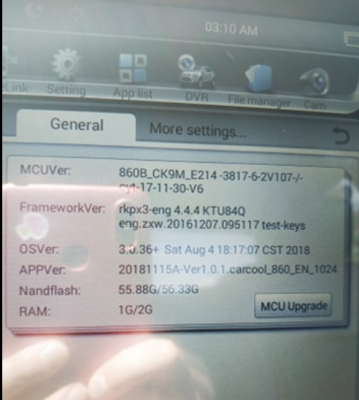

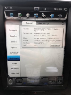

If you post an image of your system info screen I "might" be able to tell you if you have the latest Linkswell firmware or if you need an update.
Alright this is my system version screen , hope it can help . Also does the time reset everytime the truck turns off that’s a little annoying having to set the clock every time
Note: @JustLovett0 can chime in if I have any of this wrong...
It looks like there is an update. What Linkswell refers to as GENII App 2.3. You can download the firmware for 2.3 here...
Hey Jesse, not sure if you Called Linkswell yet, but if you do, ask for "James." I work the phones here for tech support.
Bluetooth should still be playing audio in the background... Even when you press the home screen icon, it doesn't work? I haven't heard of that before.
Basically this is a situation where Android has to determine which app you want to play audio through. Look in the very top right of the screen for an icon with two boxes. (Multitask). Swipe to the left or right to close apps in the background, and see if anything changes.
PM me your email, or give the Linkswell number a call and I'll see if we can send over an update to fix this.
The White Dongle for Carplay does use an App. It's called "AutoKit." You might need to open the app on the homescreen that says "Phone Link," as it should tie into the app. If the "PhoneLink" button doesn't do anything, or the "Autokit" app isn't in the AppList, you need to re-install it. Instructions and download links are on the website: Linkswellinc.com

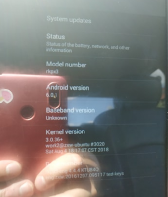

The software for these Android units is stuck to what they came with from the factory. If you updated android, it would mess up some pretty critical functions, like climate control.
The Linkswell Gen II Unit you have (PX3) is running Android 4.4.4, but the Android settings menu will Say android 6.

Woah!!! Let's Not run the Gen II updates on this unit. @Jesse farias that isn't a Gen II linkswell Radio, exactly.. That's an "Amazon" Linkswell radio. It has our Gen II Hardware, but the Gen 1 software. If you look to run any updates from our website, make sure it's the Amazon Unit specific updates, or your radio has a possibility (usually a 40% chance) to burn up and stop working.
http://www.linkswellinc.com/amazon-t-style-radio-firmware-updates/
Your software is up to date, however. MCU version is F027, and the APP Version is "2019 03 01." No need to update unless some issues or problems come up with your radio.

1. First we start with the move of wires on the radio side of the harness. With the locking clip faced down, move these wires up...
2. Then you will add wires in these positions on the truck side of the harness...
3. Finally, you will take the wires you added on the truck side and add them on the radio side in this order...
That's it! After this you should have a working 6 speaker system!
