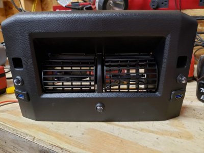

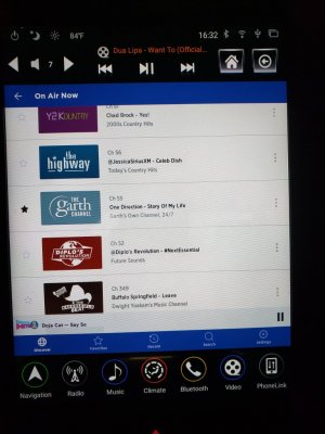

Linkswell Gen 4 installed, 2018 Ram 2018, side camera and front camera installed also.
Highlights;
Everything works on it, sounds pretty good. I downloaded poweramp (walt @ adc suggested it)
my 256gb from amazon plays all videos using the factory usb in the center bench seat console -dont need that aftermarket one
android auto works just fine(cables are hidden in the pull out cubby underneath the radio)
I change my door speakers to all Alpine 6x9 and added a Alpine 4 channel -it jams
the subs are ok RF p2, I have some JL also I might swap em

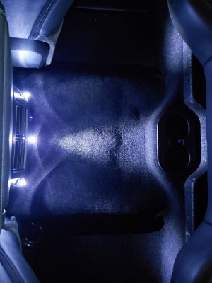

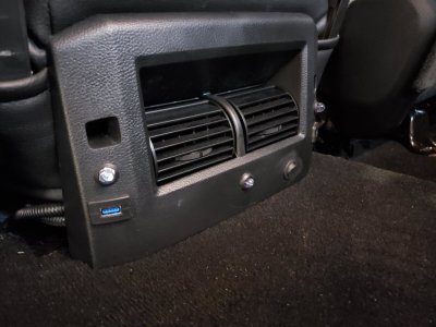

I added leds in the console along with USB's for the back seat little ones. they need to charge devices. I soldered the wires together.
front camera image is backwards (Pcam-110) says it works on front of vehicle so need to sort that out.

I installed those same USB ports up front so I wouldn't have to open the console lid for a charging port. Amazon LOL!!!
so I stripped the wire and only connected the red n black up (soldering them) to power and ground. When I connect my phone it does complain but looks to be charging. I have one more I am going to install in the glove box I think
Im guessing you have an iPhone and you get the accessory not supported message? I plugged my phone in and did the pin hole reset and it connects as it should now no message.

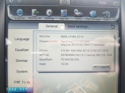

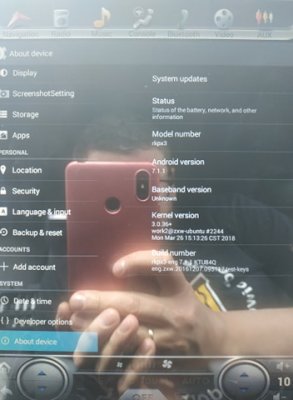

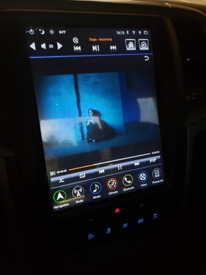

Hi All,
I bought this radio from a user (not of this forum). I have Ram 2013 5.7 hemi the low budget edition express. I originally had the lowest radio + manual A/C.
When i connected the tesla style radio i had huge issue with the A/C, but i manage to set this thing correctly using the setup in hidden menus. I put in attachment the version of radio and software that i have.
I have issue with the speakers. The front ones doesnt play at all. is there any setup that will work ? Please help.

View attachment 209290 View attachment 209291
I would check to see if the previous owner had the fade set all the way to the rear on the EQ settings. If that's not the problem I would check my connections.

I'll PM you updated firmware tomorrow to try.
